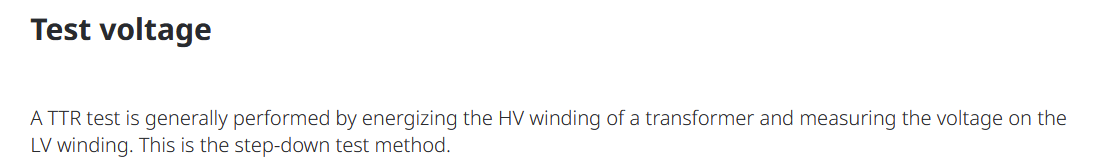

Application of TTR Test Voltages?
From the test:
From the material:
Conversely, from Megger:
My understanding of the topic was that we wanted to excite the HV windings in order to minimize the generated voltage; applying 100 and making 25 is much safer than applying 100 and making 400?
Any insight would be appreciated.
