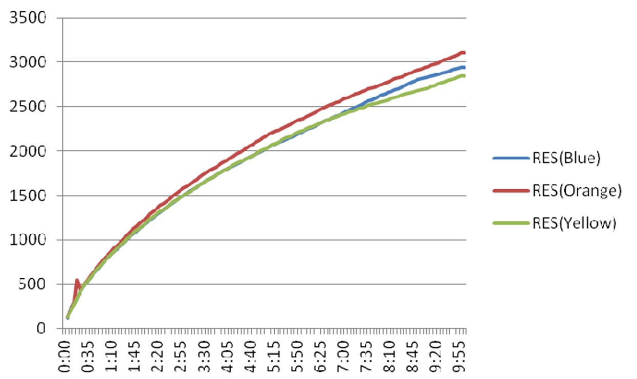

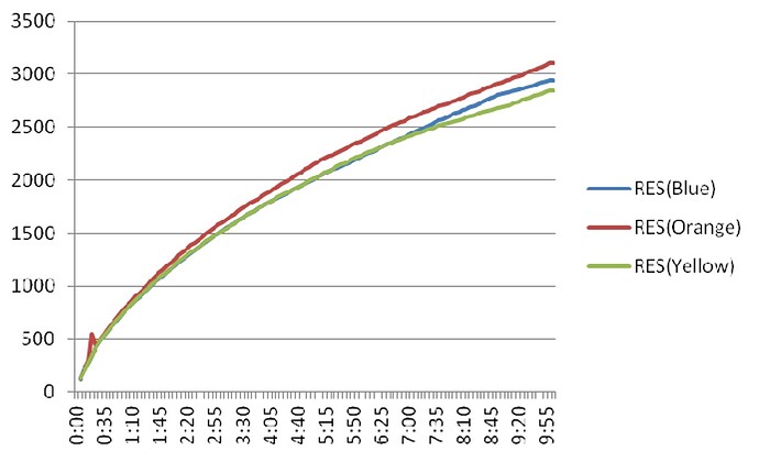

1. Insulation Resistance Profile (IRP)
Insulation Resistance Profile plots the insulation resistance of an apparatus over time. Photo: MotoDoc LLC
An Insulation Resistance Profile (IRP) provides a detailed graphical representation of an insulation system’s resistance over time. This profile is created by taking resistance measurements at regular intervals, such as every 5 seconds, over a specified duration, typically 10 minutes.
The resulting data can help identify the condition of the insulation system, which generally falls into one of four distinct profiles:
  • Normal: Indicates healthy insulation with no significant issues.
  • Moisture: Suggests the presence of moisture within the insulation material.
  • Contamination: Points to impurities or foreign materials affecting insulation performance.
  • Embrittlement: Reflects aging or degradation that makes the insulation brittle and less effective.
Additionally, when the insulation resistance exceeds 5000 megohms, the IRP may reveal subtle characteristics that could otherwise go unnoticed, offering further insights into the insulation’s condition.

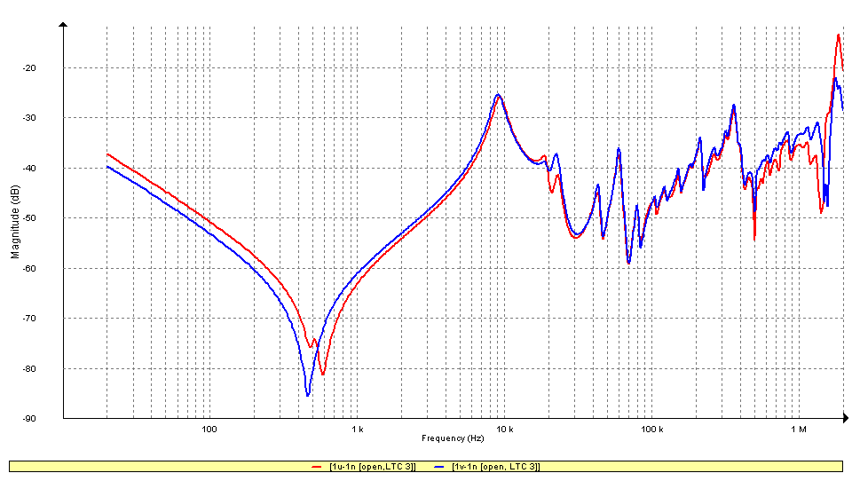

2. Sweep Frequency Response Analysis (SFRA)
SFRA gives a detailed look at how a transformer responds at different frequency ranges. Photo: Indiamart.
Sweep Frequency Response Analysis (SFRA) is an advanced diagnostic method used to evaluate the mechanical and electrical integrity of equipment containing windings, such as transformers and reactors. The technique involves sending a signal across a range of frequencies into the windings and measuring the response signal that returns.
The results are then analyzed by comparing them to a reference, such as a baseline test performed when the equipment was new, or to results from previous tests. This comparison helps detect potential issues, such as mechanical damage, physical deformation, or electrical changes within the windings.
SFRA is a versatile tool used in various scenarios, including:
  • Baseline Testing: Establishing a reference for new transformers.
  • Routine Diagnostics: Monitoring equipment condition during regular maintenance.
  • Post-Fault Testing: Assessing potential damage following a system fault or incident.
By identifying subtle changes, SFRA allows for early detection of problems, reducing the risk of unexpected equipment failures.

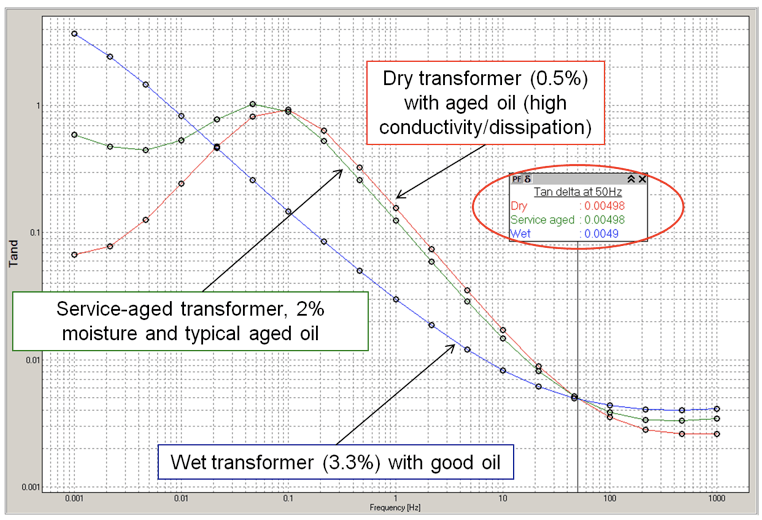

3. Dielectric Frequency Response (DFR)
Dielectric Frequency Response is used to measure dielectric losses and capacitance. Photo: INMR.
Dielectric Frequency Response (DFR), also known as Frequency Domain Spectroscopy (FDS), is a non-destructive diagnostic method used to assess the condition of insulation in electrical equipment such as power transformers and cables. This technique measures a material’s dielectric losses and capacitance across a wide range of frequencies.
DFR is particularly effective for evaluating insulation health and estimating moisture content within the system. The process involves measuring the dielectric response of the material and comparing it to a theoretical model to determine critical parameters such as moisture content and oil conductivity.
The results of DFR testing are typically presented as curves that plot:
  • Capacitance
  • Dissipation Factor (Tan δ)
  • Power Factor
These values are charted against frequency, providing a clear view of how the insulation performs under different electrical conditions. DFR enables technicians to identify moisture, aging, or contamination within insulation systems, allowing for accurate diagnostics and timely maintenance decisions.

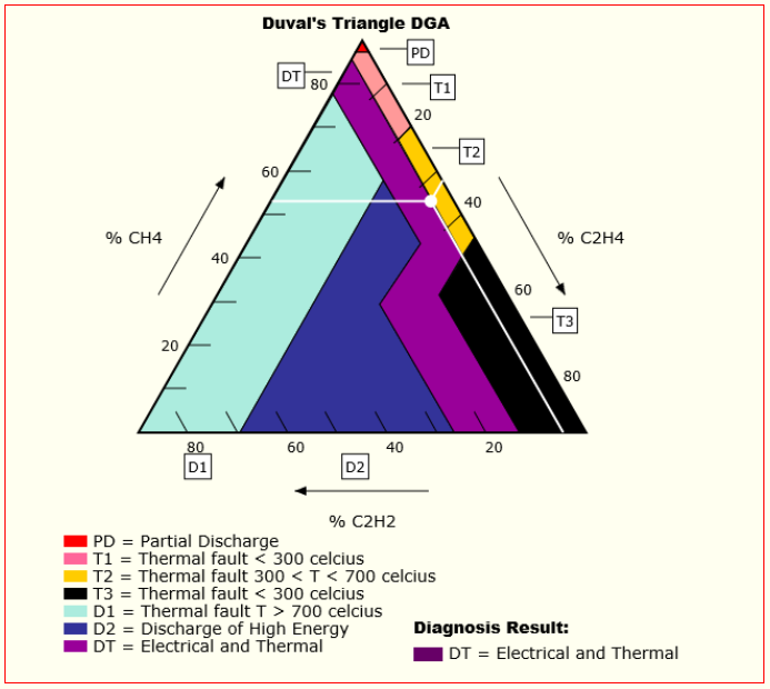

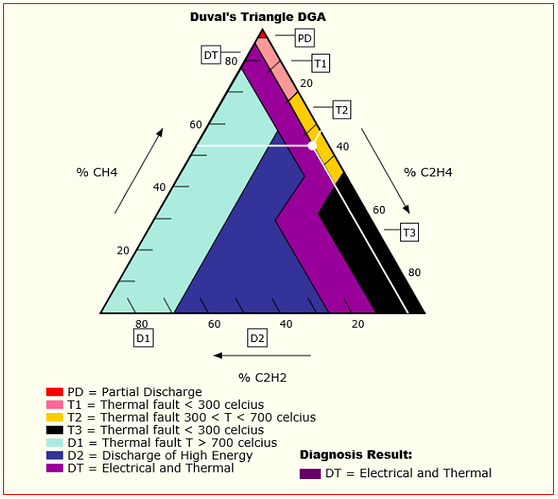

6. Continuous Liquid and Gas Monitoring (DGA)
DGA can be used to categorize transformer faults, based on the relative amounts of methane, acetylene and ethylene. Photo: Github.
Continuous liquid and gas monitoring systems provide real-time insights into the health of power transformers by analyzing dissolved gases within their insulating oil. This technique, commonly referred to as Dissolved Gas Analysis (DGA), is a critical tool for proactive transformer maintenance.
The system continuously measures the concentration of key gases dissolved in the oil, such as:
  • Hydrogen
  • Methane
  • Ethane
  • Ethylene
  • Acetylene
  • Carbon Monoxide
  • Carbon Dioxide
Abnormal levels of these gases can indicate potential issues, including:
  • Overheating
  • Arcing
  • Partial Discharge
By detecting gas level changes early, DGA enables operators to identify and address problems before they escalate into significant failures. This early fault detection allows for timely interventions, reducing the risk of unexpected downtime and extending the transformer’s operational life.
Continuous DGA monitoring is regarded as a cornerstone of transformer health assessment and a vital part of predictive maintenance programs in modern power systems.

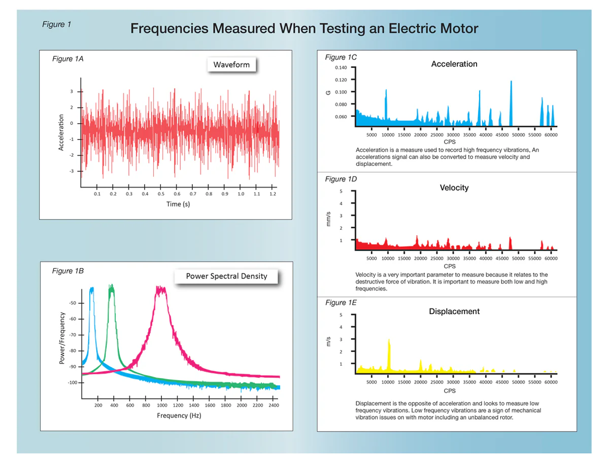

9. Vibration Analysis
Motor vibration analysis frequencies measured. Photo LEI Corp.
Vibration analysis of electrical motors is a diagnostic process that measures and analyzes the vibration levels and frequencies of a motor to evaluate its health. This technique is important for identifying potential issues that could affect the motor’s performance, lifespan, or efficiency. Vibration analysis is widely used in industries such as aerospace, manufacturing, and automotive due to its effectiveness and reliability.
Vibration analysis can be used for several purposes:
  • Finding and Repairing Developing Problems: Identifies early signs of wear or damage before they become critical.
  • Detecting and Monitoring Chronic Problems: Tracks recurring issues to manage long-term maintenance needs.
  • Establishing Acceptance Criteria for Testing: Sets benchmarks for motor performance during acceptance testing.
  • Predicting Failures: Forms part of a predictive maintenance strategy, allowing for proactive repairs.
To perform vibration analysis, an accelerometer is attached to the motor. This device generates a voltage signal that corresponds to the level and frequency of the motor’s vibration, providing valuable data for diagnosing potential problems.
