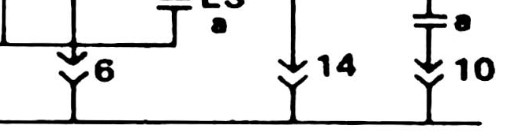

(>> #) Secondary Disconnect
Control voltage for electrical operation is supplied to the circuit breaker through the secondary disconnect. The secondary disconnect also serves as the interface for the auxiliary contacts on the circuit breaker to the associated switchboard and provides indication to the control system about the breaker’s position.

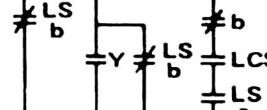

(Y) Anti-Pump Relay
Anti-Pump Relay
Locks out the control circuit if the close operation is not completed. If the breaker fails to close on the first attempt, and the close coil remains energized, the “Y Relay” initiates a lockout to prevent the breaker from attempting another close.
If the close signal is initiated but not removed, the breaker has the potential to cycle through an endless close, trip, charge, close, and trip cycle (Pumping). The Y coil opens the Y contact in the close circuit, and as long as the close signal is present, the circuit breaker cannot re-close.

(Lsb) Motor Cutoff Switch
Usually operated by a timing cam, this switch opens the normally closed contacts and de-energizes the motor when the breaker is charged. It may also include a set of normally open contacts that close and complete the circuit to the close coil.
(LC) Latch Check Switch
A mechanically-operated switch which senses if the trip latch is reset. Indicates when the breaker is “ready to close.”

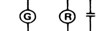

(G) Green Indicating Light
When the breaker opens the green lamp illuminates – the circuit is complete with 52b contact switching from open to close.
(R) Red Indicating Light
When the breaker is closed and energized, the red lamp illuminates to indicate a live breaker. The trip circuit is “armed,” and once a control switch or protective relay contact is operated, the breaker will open.
