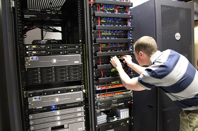

Server Rack
The final destination for the electrical journey is the server rack, which the is most critical component of the Data Center. The term “rack” refers to the physical structure that houses servers, cables, and other equipment.
The server rack is the most critical component of the Data Center. Photo: Wikimedia.
Everything will fit neatly into the framework, helping to stay organized and safely off the floor. Within the server rack are the computer systems and network infrastructure that provide online services and store important data across the internet. All other systems within the building exist to support keeping the server racks running efficiently.
