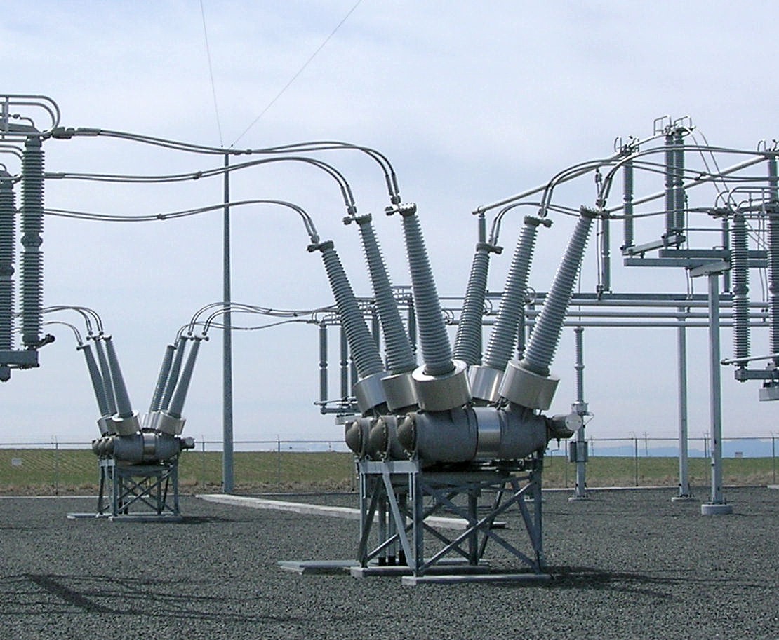

Circuit breakers at substation near Denver International Airport, Colorado. Photo: Wikimedia.
Circuit breakers are designed to manage current flow under normal conditions and interrupt it during faults. While they may remain dormant for extended periods, circuit breakers must operate quickly and reliably when called into action.

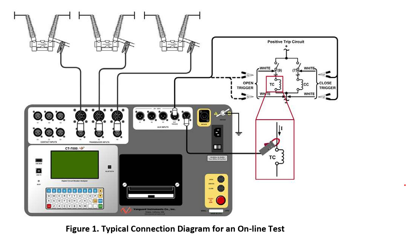

First trip testing evaluates circuit breaker performance by observing the trip cycle while connected to the power system, prior to isolation for maintenance. This test captures important data about the breaker’s operational health, including contact time, coil current, DC voltage, and auxiliary contact timing.
Typical wiring diagram for circuit breaker first trip test. Photo: Vanguard Instruments.
By simulating real-world conditions, first trip testing reveals issues that may not be evident in off-line tests. Uncovering these issues early allow technicians to focus on repairs that ensure the breaker can respond effectively during a fault.

1. Contact Time
Determined using non-contact AC current probes connected to the secondary winding of the breaker’s current transformer (CT). These probes detect the presence or absence of main contact current. A timer, triggered by the trip or close command, calculates the contact time based on current flow changes.
2. Coil Current
The amplitude and waveform (signature) of the trip or close coil current are recorded. This data helps identify issues like sticky trip latch components or loose control circuit connections.
3. DC Voltage and Auxiliary Contact Timing
This test monitors the control circuit voltage and the timing of auxiliary contacts, which are essential for coordinated breaker operation.
The collected data is compared to manufacturer specifications and previous test results to evaluate performance. For example, deviations in the trip coil current signature may indicate mechanical drag, while voltage irregularities could point to battery or cabling issues.
