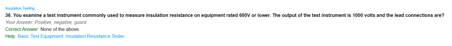

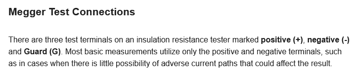

From the cited reference page:
Is there something I’m missing?

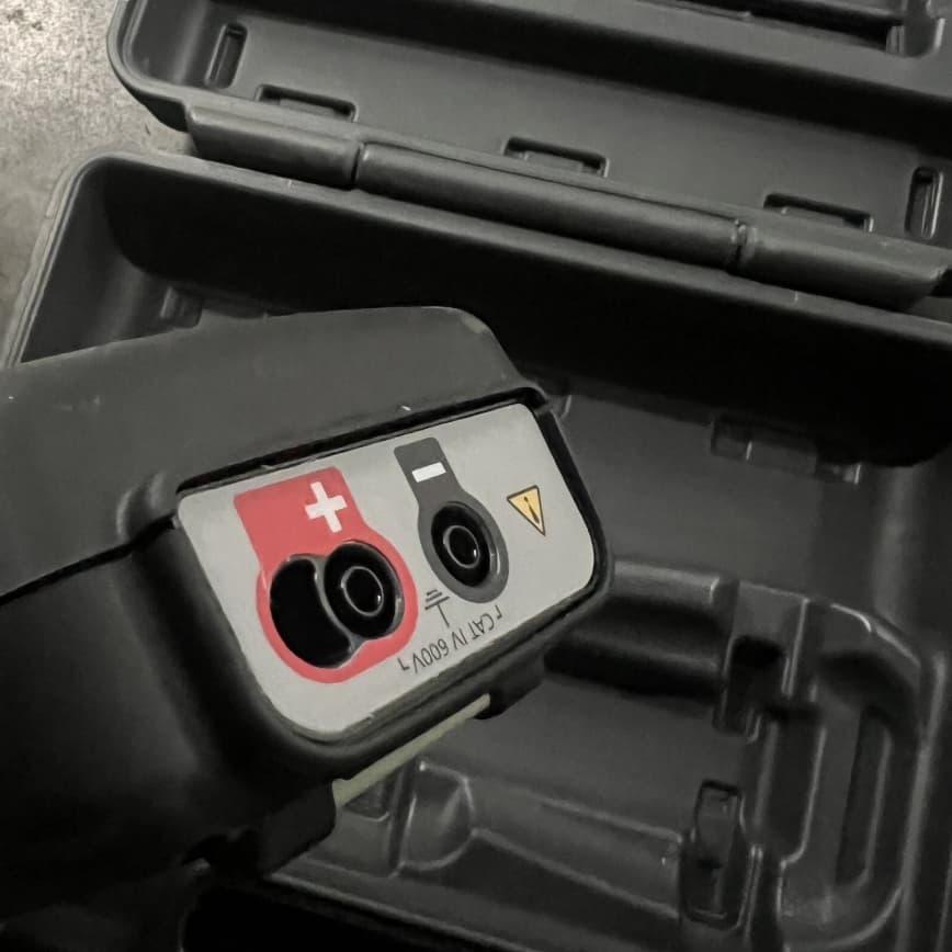

I think the key here is “on equipment 600V or lower”
Its not uncommon to find testers rated for 600V without a guard terminal, only Positive (+) and Negative (-). The reference material could probably use an update to make this more clear.
Huh, today I learned. Thank you!
