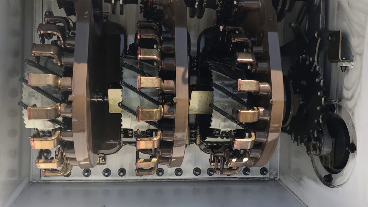

It is generally safe to cycle the LTC with the oil drained. This is how you perform an internal mechanical inspection. You can run certain tests under these conditions, usually low-current DLRO or other small measurements, not HV insulation testing as this would require the oil. Here are some videos of a LTC operation:
