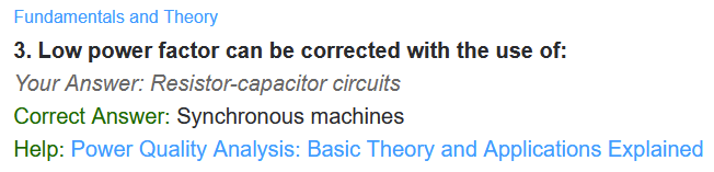

Low power factor can be corrected with the use of?

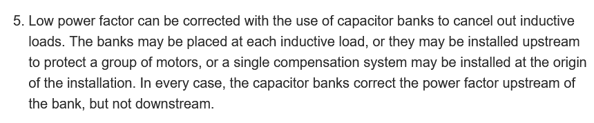

From the reference material:
I feel like this might be a phrasing of the question problem? I understand that a leading or lagging power factor can require capacitors or inductors to correct, but I’m used to people referring to too much inductance as the ‘low’ power factor.
