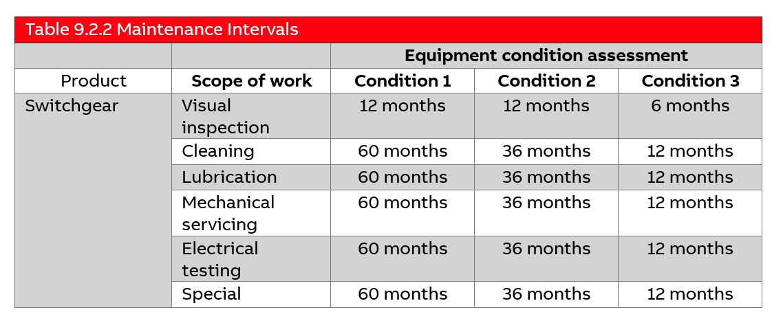

A key feature is Table 9.2.2, which defines maintenance intervals based on the type and condition of equipment, ensuring optimal safety and performance.
Maintenance Intervals: Table 9.2.2
Table 9.2.2 specifies maintenance intervals based on the type of equipment, such as busways, circuit breakers, or grounding systems. The intervals are further adjusted by evaluating the physical condition of the equipment.
Section 9.2.2 emphasizes the importance of adhering to manufacturer recommendations when available. If manufacturer guidelines are unavailable, maintenance must occur at intervals specified in Table 9.2.2 when equipment failure poses unacceptable risks to personnel or the environment.
NFPA 70B Table 9.2.2 Maintenance Intervals. Photo: ABB
