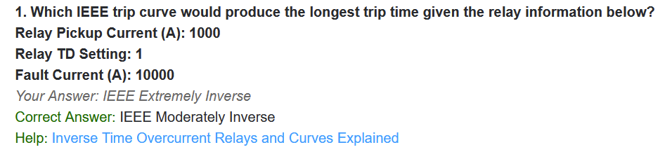

Which IEEE trip curve would produce the longest trip time given the relay information below?
Even the given reference picture clearly illustrates C-11 / extremely inverse as the ‘slowest’ trip curve, per multiple of pickup current - which makes sense to me, as it has the most inverse relationship with the multiple. Can anyone offer any insight, here?
