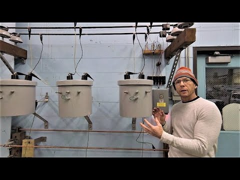

Super interesting situation. Tbh I’m no expert in this area but I’ll take a stab at it.
The ferroresonance thing is completely not a concern. Here is a great video explaining ferroresonance.
I’m also not buying that changing a customers transformer wiring is going to prevent the “POCO”?? ( I assume this means utility co.??) from having issues. I’d say if the utility is burning up “static straps”?? (Again, sorry don’t know what you mean by this) they the utility needs to upsize those conductors b/c they are likely undersized.
