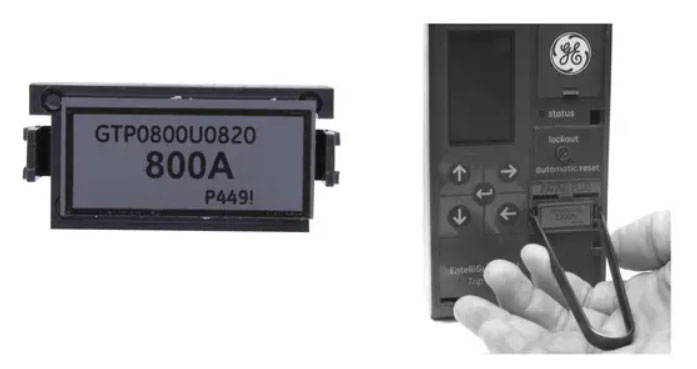

1. Removable Rating Plug
In addition to the adjustable protection functions, the trip unit is designed to use field interchangeable rating plugs. These rating plugs allow the ampere rating of the circuit breaker to be changed to meet specific applications.
Trip Unit Rating Plug Example (GE Entelliguard). Photo: General Electric
By changing the rating plug, the User can easily change the range of current protection settings without having to remove the circuit breaker from its enclosure.
