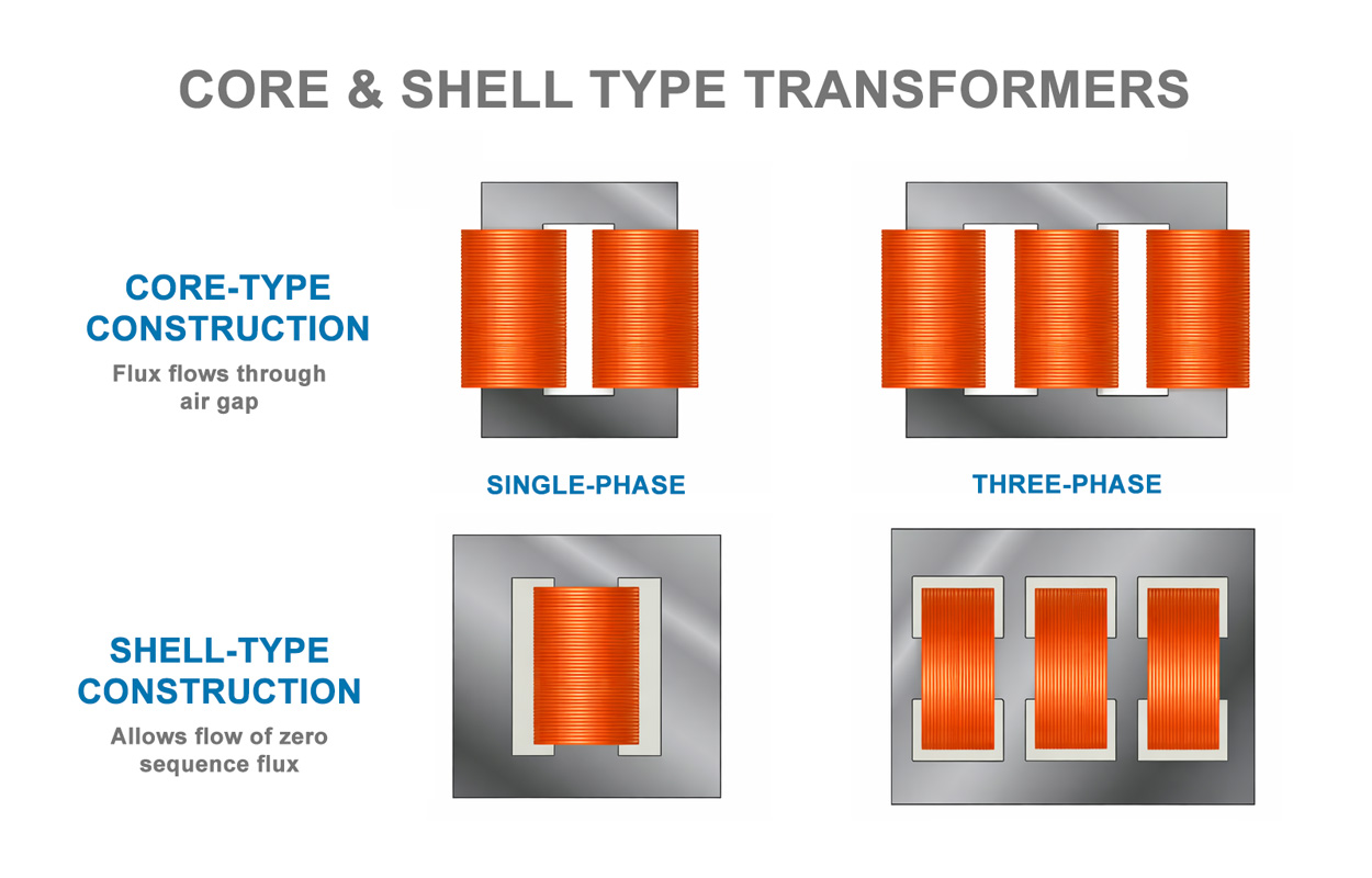

Core-Type Transformer
In a core-type transformer, the core has three legs, one for each phase in a three-phase system. The windings are wrapped around these legs, and the legs are connected by yokes (horizontal sections of the core) at the top and bottom. The magnetic flux flows through the legs and yokes, linking the three phases.
Shell-Type Transformer
In a shell-type transformer, the core has five legs. The three inner legs hold the windings, similar to the core-type design, but two additional outer legs surround the windings. This creates a “shell” that encases the windings, providing extra paths for magnetic flux.
The shell-type transformer is more complex to build because it uses more core material (iron) and has a more intricate structure. As a result, shell-type transformers are typically more expensive and harder to maintain than core-type transformers.

Flux Paths
The two extra outer legs in a shell-type transformer provide a dedicated path for zero sequence flux. These legs guide the flux around the windings and back to the core, keeping it contained within the core material.
