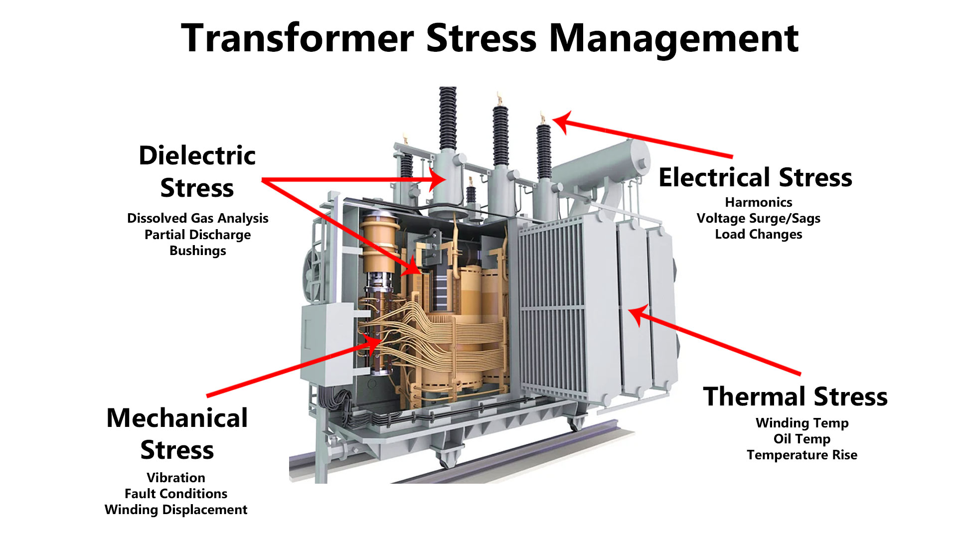

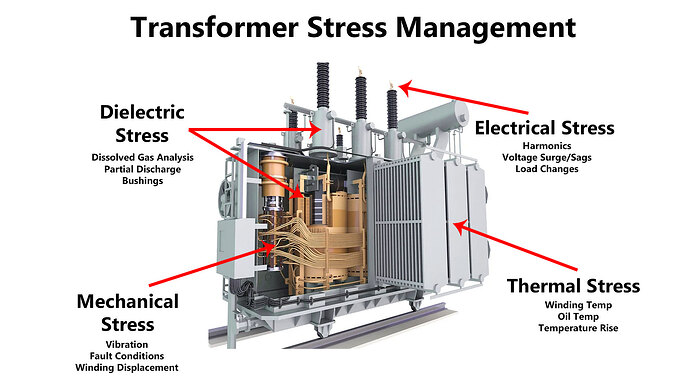

Power transformers are among the most critical and expensive assets in the electrical grid. Their failure can lead to widespread outages, expensive repairs, and long replacement times. To mitigate the risk of failure, utilities rely on real-time monitoring systems that track the key stressors affecting transformer lifespan: thermal, mechanical, dielectric, and electrical stress.
Rather than reacting to failures, modern utilities take a predictive approach by continuously analyzing transformer health to detect early warning signs and intervene before damage occurs.
Thermal Stress: Managing Heat and Aging
Heat is the primary driver of transformer aging, especially when it comes to insulation degradation. Utilities monitor thermal stress using infrared, winding temperature sensors (often fiber optic probes embedded internally), top-oil temperature sensors and load current measurements to estimate internal heating.

Mechanical Stress: Detecting Movement and Fatigue
Mechanical stress occurs when internal components shift or vibrate due to electrical forces, especially during events like inrush current or fault conditions. Utilities monitor for this type of stress by using vibration sensors mounted on the transformer tank, acoustic sensors that detect internal movement or anomalies, and electrical signature analysis to observe winding displacement.

Dielectric Stress: Protecting Insulation Systems
Dielectric stress affects the transformer’s insulation system. Breakdown of insulation is a leading cause of catastrophic failure.

Electrical Stress: Tracking Power Quality and Events
Electrical stress comes from irregularities in the power system, such as harmonics, voltage surges, and load fluctuations. Utilities monitor electrical stress using power quality meters, digital protection relays, and fault recorders.
