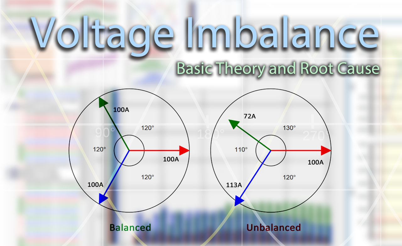

Voltage imbalance is defined where the three-phase voltages deviate from equal magnitude and 120° separation. Even imbalances as small as 2–3 % can cut motor life by half and raise system losses.

Unequal line impedances produce different voltage drops in both magnitude and phase angle across the three phases. This may be caused by untransposed lines, single-phase laterals, or mismatched equipment. These angular shifts mean the 120° separation between phases is lost, even if magnitudes appear close.
The result drives negative-sequence currents that cause additional heating and torque pulsations in motors. Phase-angle imbalance is especially dangerous because standard voltmeters may not detect it; only sequence-component analysis reveals the full extent of the problem.
